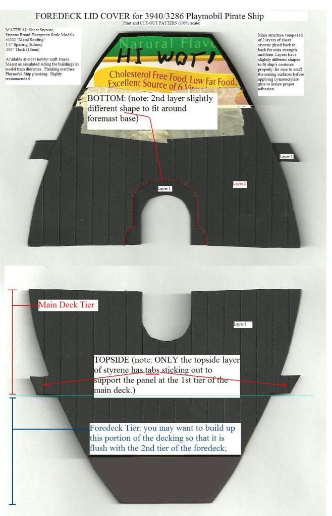

DECKLID PATTERN for 3490/ 3286 Pirate Ship Foredeck
« on: October 03, 2010, 01:11:39 »
**********WAIT READ BEFORE PRINTING!  SOMEHOW, at least on my comp, I can't get it to print in the correct size from internet explorer!  It keeps scaling it up!  If this happens to you do the following:
1. click the direct link in this thread
2. in internet explore go to file menu and click "print preview."
3. in print preview change default dropdown menu from "shrink to fit" to "custom."
4. type in "74" under custom size (for 74%)
5. THEN print.
 In all, the widest part of the base should be 10.6 cm wide (not including the tabs).  Sorry!  Good luck!****
Hi all,
This is for anyone who is annoyed by the gaping hole in the foredeck of their 3490/ 3286 Pirate Ship who may want to create a removeable deck lid for it.
I made a lid for my Black Pearl ship, but per WOT's request I made a template for a slightly different lid to fit a stock 3286 / 3490 Ship.
=http://i160.photobucket.com/albums/t188/BlackPearl2006_album/Playmobil/Pearl_Decks_n_Ports/3286DECKLIDpattern.jpg
Materials you will need include
printer (to print out the template),
1mm thick sheet styrene (preferably with 1/4-inch-spaced "planks" to simulate the deck planks),
tape (to tape the template onto the styrene for tracing),
sharpy marker (to mark the pattern)
high-quality sharp/strong scissors or exacto knife (to cut the styrene to shape and to scuff the mating surfaces of the styrene sheets to be glued back to back)
cyanoacrylate glue
optional: dremel, or drill to bore mounting holes for wire loop for easier handling during removal of decklid (to gain access to guns).  Coated wire/twist tie (for the loop)
Basic Instructions:
1. print pattern
2. trace pattern onto styrene
3. cut styrene shapes
4. glue styrene.
5. drill holes
6. mount wire loop.
Fin.

Oh, that's how!
Thanks again for the pattern! ;D

You can "thank" me by taking pics of your mod and posting it here :D
Re: DECKLID PATTERN for 3490/ 3286 Pirate Ship Foredeck
« Reply #3 on: October 03, 2010, 05:34:43 »
Tomorrow, I have already made a cover. ;D
Just to tired to take pics tonight.

A very neat idea and thanks for sharing it.  I'm using a similar but simpler decking idea on an old modified 3750 using that style of sheet plastic.  I can't remember the maker's name, but its Green-something.  Railway shops sell the stuff or it can be bought on line.

The name of the manufacturer of sheet styrene I used is everGREEN.  Maybe it's the same as your GREEN-something?
What part of the 3750 are you modding?  Since the 3750 has no uncovered hatches on deck, unless you're replacing a missing hatchcover that leads to the cargo hold, I'm guessing you're adding an additional level of decking perhaps?  Like a second tier of deck?  Quarter deck or forecastle perhaps?  You have me very intrigued......  Please, do tell!
