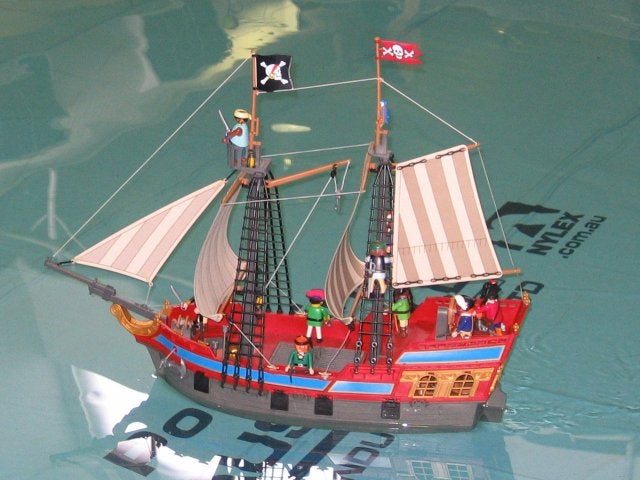

Finally found a 3286 conversion to RC.   (not mine).  As you can see, the customizer "waboats" from rcgroups.com forums ended up sealing the gunports shut to prevent water from coming in and capsizing the ship.  Not too crazy about the placement of the prop or the moulding job (he didn't sand it smooth or make it look stock)...maybe he did that to conceal the use of the prop.  he writes:
Quote
"I have had quite a good success with the Pirate Galleon from Playmobil.
Every time it hits the water the kids are amazed and all want to have a go..
It runs on a direct drive 360-14 motor by electronize with two channel control. Not for outside on the pond but a great indoor or sheltered water novelty. Uses existing ballast bulb and has a few extra Pirate bits & bobs for effect.
I use a small Li-Po battery I got from a Heli I crashed & burned..
I have sponge around the electronics in case a small amount of water gets in. Not sealed and comes apart where the toy does. Only trade off on the hull was I glued the Gun Ports in place permanently.
Keeping it out of the wind is the trick..
Run Time is about 1 hour. "
