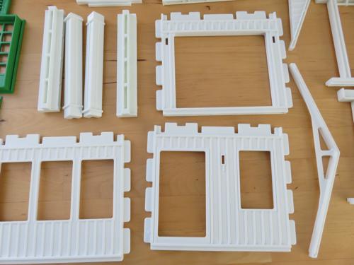

I had very good results cleaning some playmobil with the chemical solution "hydrogen peroxide". I guess many of you have already done this, but nevertheless here it goes.

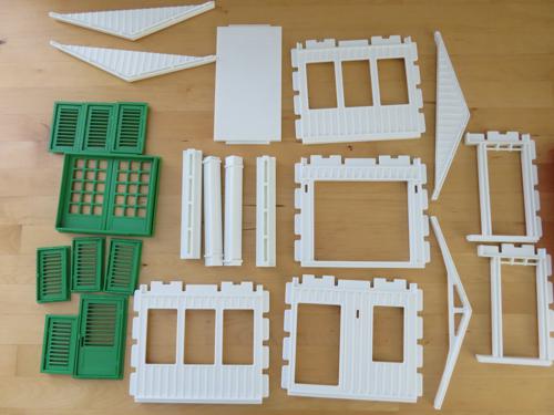

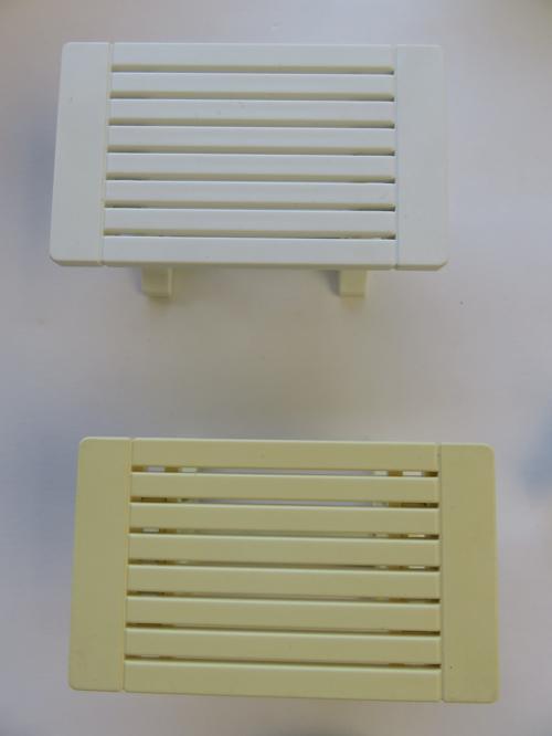

Old playmobil e.g. from the flea market, or after some time exposed to sunlight, gets darker - especially white parts. I found a table from the Victorian set 5323 second-hand and already had one of those in a very good condition. Compare them here:
And this was the result after cleaning:

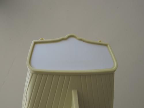

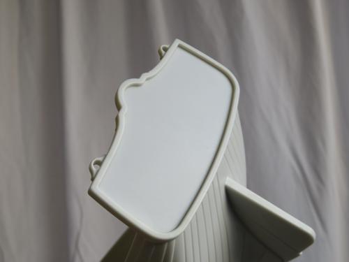

I was extremely happy with a very old 3771, which got shiny-white, as it should be:
Detail:

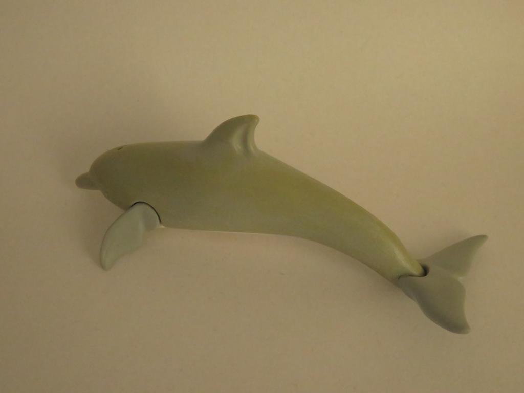

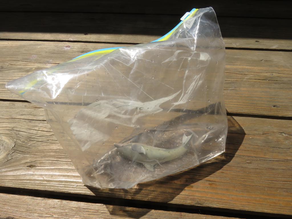

Here's a dolphin who was in need of a bath:
the dolphin inside the bag with a bit of the solution:
There is no need to fill the bag completely with the solution, because the atmosphere created with the sunlight will do the job. Just shake the bag so that everything gets moisturized.
And let the sun shine on it :) How long? Well, it depends on the measure of the discoloration... We usually left it two hours or more, but the sun here is not so strong, so maybe in the south of Europe 5 minutes will do  ;D ;D ;D

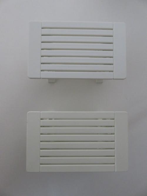

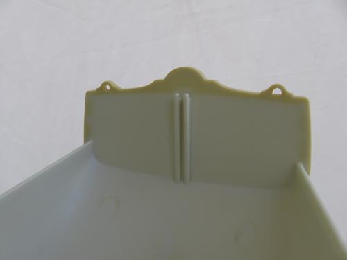

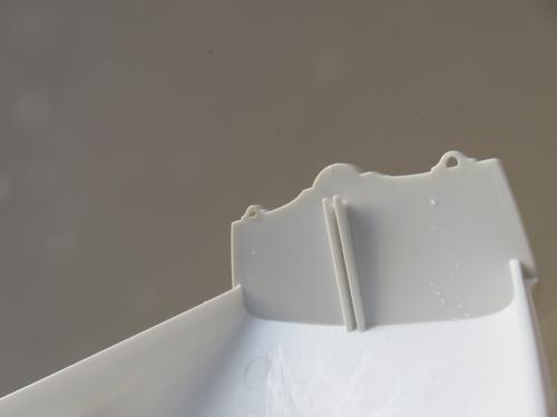

Here's the bottom of a Marine Schoner I found at a flea market recently (@Tahra: now I have a original one too, though incomplete, I might get the parts missing from the replica), before the cleaning:
And after:
That's all! Have a wonderful week, everyone!  :wave:

The dolphin doesn't even need to be submerged?
It doesn't, that's the good news, there isn't much waste. The parts should be wet, and the sun must shine on it.
