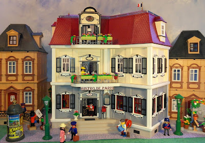

 :wave: Hi Playmogal,
as your painting a 5302 I thought you might like to see what I did with mine.
I repainted both floors and all the windows. What did you think about the door frame on the middle floor I thought is was a bit low so I swapped it for the larger one.
You don't need a dividing wall for the lights if you don't want one I hid my battery pack on the top floor behind a wine rack. I added an extra switch unit and wired all three floors from the top downwards, adding on a couple of extra lights as well.
They do look good lit up, I look forward to seeing yours.

Emma,
Love your Bistro!!! The colors are wonderful, and the full size door mantel is perfect on the floor above the ground floor.  :love:
Your lighting looks exquisite and adds so much character!
Have not painted the walls yet, but the roof, window inserts and curtains painted just fine. Should have my last two lighting kits in a day or two from US DS.
Congrats on a fine custom! If you want to post some more details of the interior, that would be fun to see.
Mine will be a house first. Then I can decide what to do with it.
This is a wonderful set for customization with so many color options and such nice trim.
Keep up the great work!!!

BB: Thanks!
WOW WOW WOW! WOW is all that comes to my mind viewing all of the photos of your lovely bistro.
Emma, thanks for posting this. Cheers, Pgal :wave:
