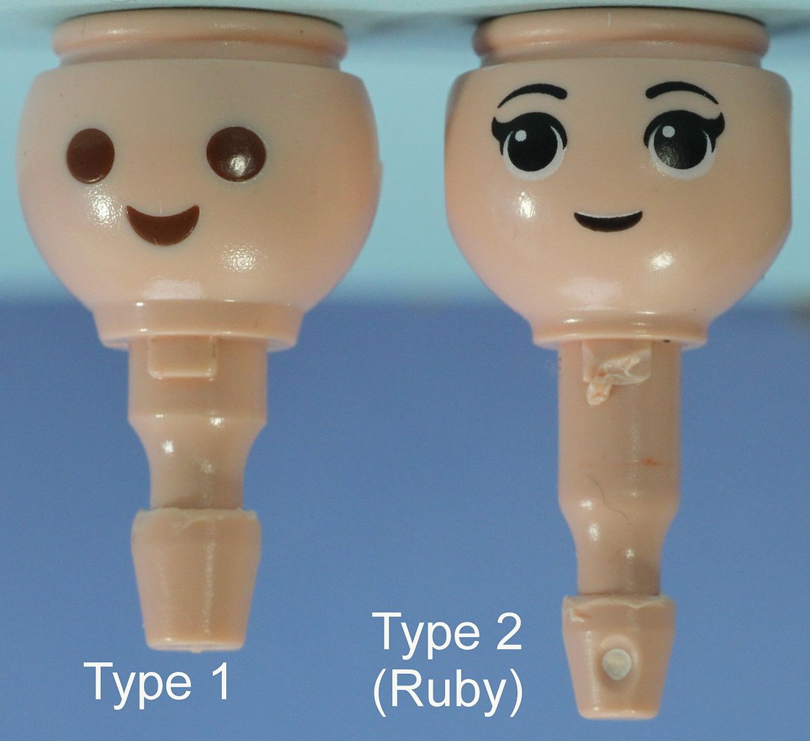

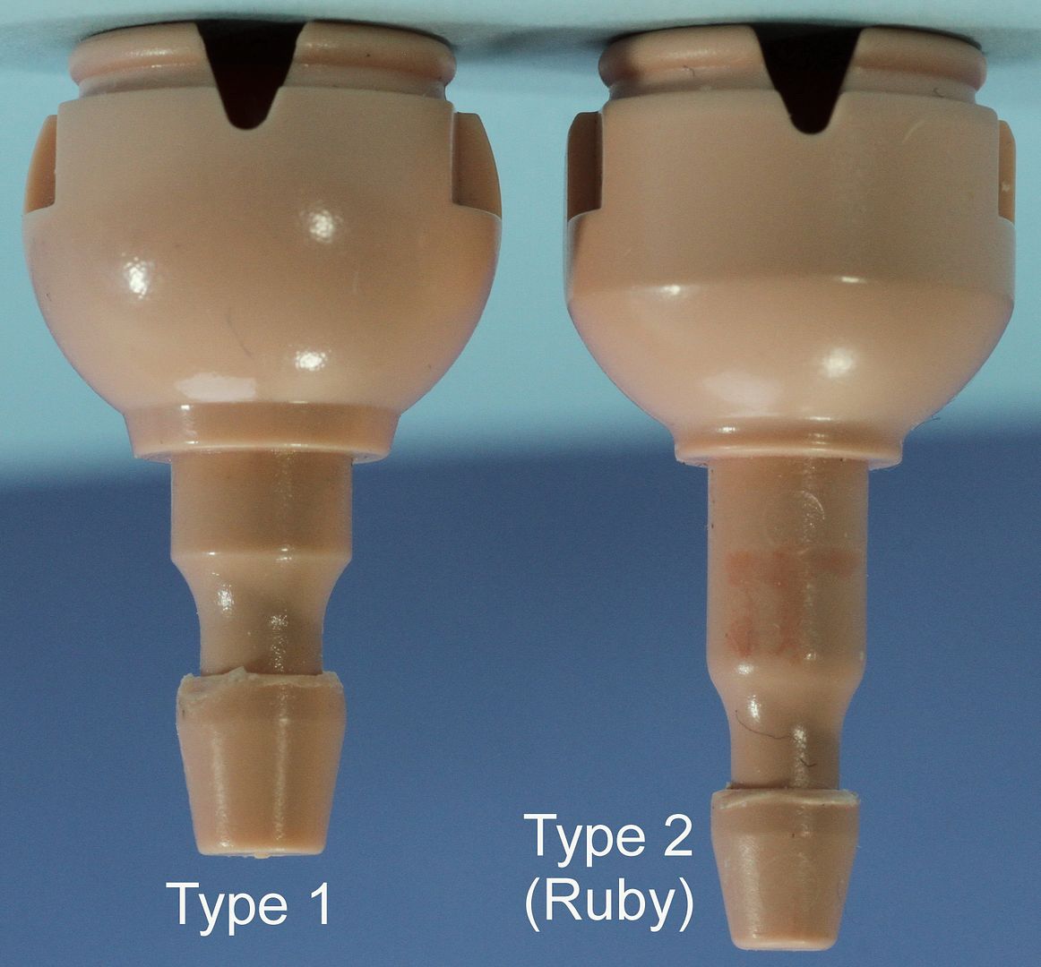

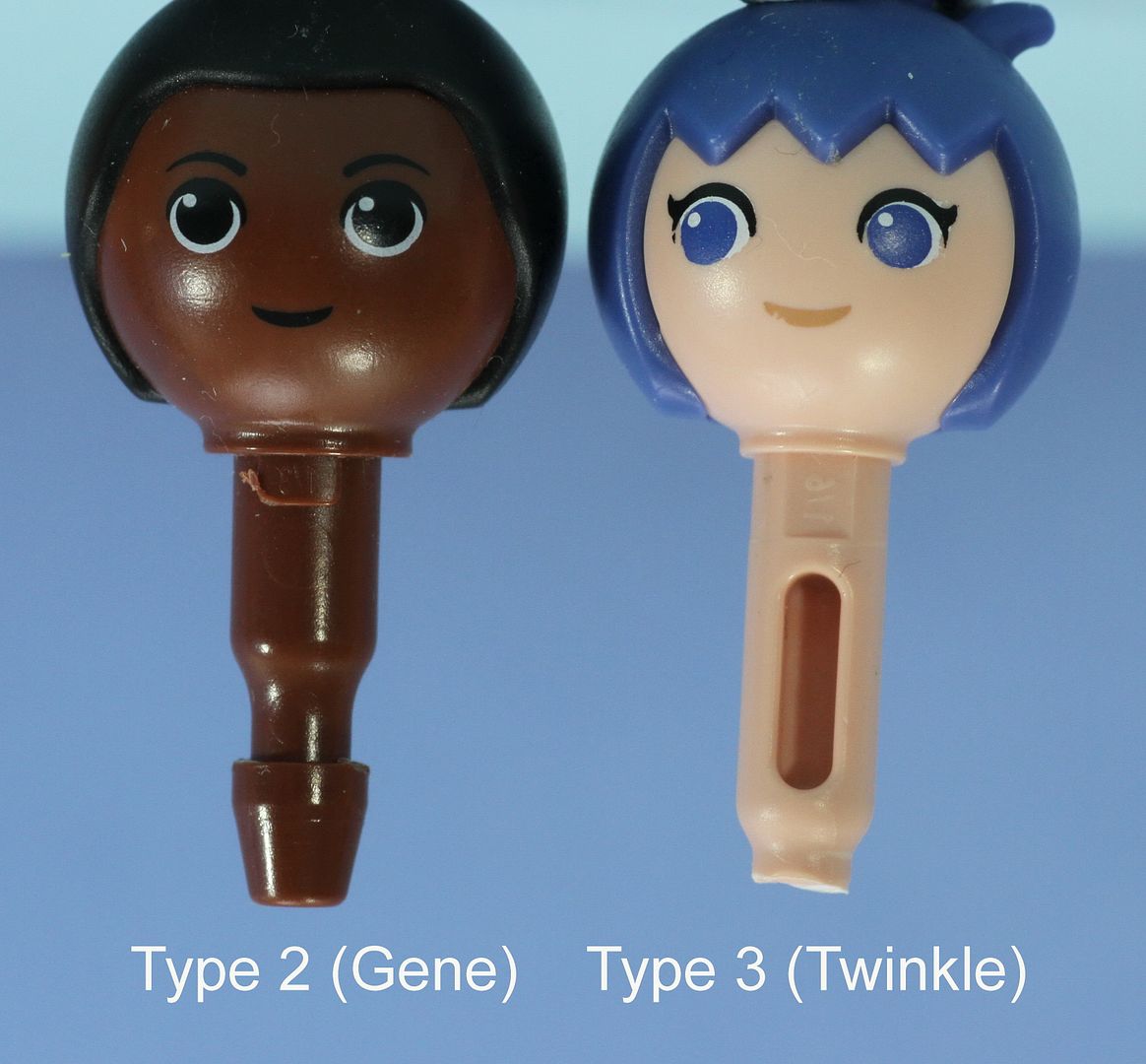

I have been thinking about this for a few days, Tahra and eventually got around to pulling heads off Super4 klickies. You are, of course, absolutely right: the heads are not freely interchangeable, but fall into those three groups.
For each type of head, I measured the diameter of the neck stem (just below the neckline) and the length of the neck stem (the part that's normally invisible inside the klicky)
1. Normal heads (Neck stem is 6mm in diameter at the top and 13.25mm long)
    This group includes Sir Gareth (30 00 6413) and the Boss Sykronian (30 00 1804), neither of which has removable hair.
2. Heads with narrow necks (neck stem is 5.25mm in diameter at the top and 16mm long)
    This group includes both non-removable hair on Gene (30 00 1804) and the Sykronian Expendable (30 00 0029) as well as removable hair (which IS compatible with all 'normal' heads) on Alex (both types 30 00 0019 and 30 00 0049) and Ruby (both types, 30 14 0019 and 30 14 0029)
3. Heads with even narrower necks (neck stem is 4.8mm in diameter at the top and about 17mm long- the end broke off the end of my Twinkle's neck when I decapitated her!)
    This group includes the four fairies, such as Twinkle (30 14 0039), Lorella (k6689), 30 14 0009 and the Quick fairy.
I have not investigated other klickies (Spirit, for example), but I think any klicky that has removable hair must have a Type 1 or 2 head. With Type 2 heads with removable hair, the back of the head is cylindrical:
So, I have modified my hair chart to make it clear that Gene, Twinkle and Sir Gareth can't actually swap heads! I have also added in the two Sykronian  styles and the rabbit heads (which, like the tall Sykronian, do not have hair at all!). Updated version here.

Yes, you are correct Tahra (as the Customizer and Dismemberment Queen, that's not surprising!). I only have one Spirit figure, Maricela and she has a Type 3 head but removable hair. So you could use the head to add a removable hair of your choice to one of the Super4 fairies, if you were so inclined....
This statement
is wrong.. Removable hair can be found on types 1(normal), 2 (Alex, Ruby) and 3 (Spirit) heads.
