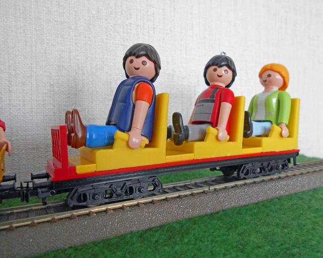

Well, that idea remained in my mind for a while, but because I didn't know how to recreate it, the idea disappeared again. Until Märklin introduced wagon 44734 and I was introduced to 3D-printing around the same time. Märklin 44734 forms a nice basis to make a construction with Lego bricks, and on the website of Thingiverse I found a design of a Playmobil chair that fits on Lego Duplo blocks. And Lego Duplo fits back on normal Lego...
When you combine all this, you can build a wagon on which Playmobil dolls can take place…
The building plan, the railway wagon is simply put together.
So much so for the theory, the practice proved to be more persistent. My cousin has a 3D-printer, and with his help the seat was printed. On Lego Duplo bricks the chair fits perfectly, but not on normal Lego. That's strange, Lego Duplo has to fit on normal Lego bricks. Unfortunately the design of the Playmobil chair for Lego Duplo bricks turned out to be a mistake. The studs on the inside of the stone should be about 1.7 mm lower than the edge of the Lego Duplo bricks, to make them fit on the normal Lego bricks. And the original designer had overlooked that. The chair also turned out to be a bit too small, but because the margins at Lego Duplo are larger, this was no problem in the original design.
My cousin, who was looking for a challenge for his 3D printer, really had something to find out. He adapted the design, made a test in cheap black plastic and it fitted perfectly. The final design was made in yellow plastic, which fits wonderfully well with the yellow Lego bricks.

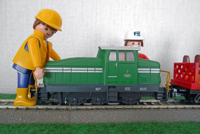

The complete train. The locomotive comes from a starter set of Märklin. Looks like the new owners and passengers have a lot of fun with it.
