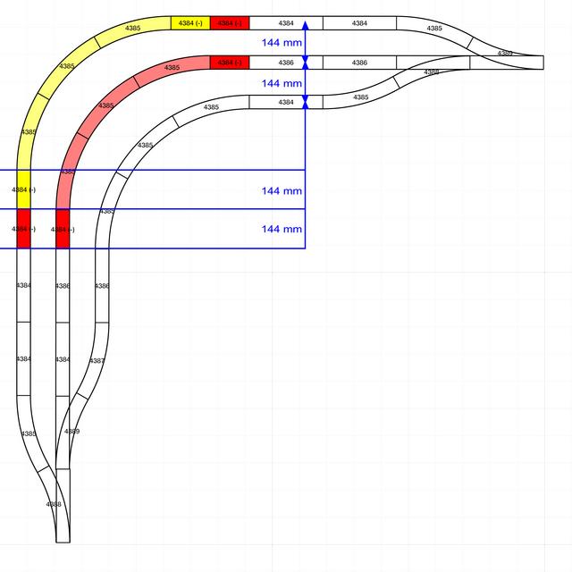

2) However, I also know of a simpler solution that applies to every model train brand, every scale and every range of rails: create a straight rail that is as long as the heart-to-heart distance from a parallel rail. If you lay a track of plastic Playmobil rails, and measure that heart-to-heart distance, you get to a length of 144 mm. This 144 mm straight track can be added before and after every quarter turn. For each track next to it, add an extra straight 144 mm before and after each quarter turn. With only one pice of rails it is possible to lay as many parallel tracks as you like. Moreover, a straight piece of track is easier to develop than a curved piece of track.
For clarification also see the track diagram below:

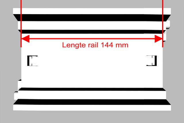

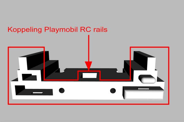

Good, problem described and solution found, now the piece of rail has to be designed. I am very enthusiastic about 3D printing, but unfortunately I don't have a 3D printer and I don't know anything about design programs. But fortunately I often know how to organize the right people together and find the basic material on the internet. On the website of cults3D.com I found the design of a railroad crossing by Lego Duplo, but made suitable for Playmobil rails. For a small amount of money you can download this design. The most important part of this design are the adaptors at both ends of the level crossing that allow the coupling of the level crossing with Playmobil rails. If you take these adaptors as a basis, remove the level crossing and fill in the space to 144 mm then you have the rails I'm looking for. My cousin Edwin ("Ed Steam", Eastern Balcony Railway) had made signposts for me before, but was now looking for a slightly more advanced challenge. I was also lucky that his company had just bought a professional 3D printer that needed to be installed.
But first I had to work on it myself. With Photoshop I could open the 3D design and make a preview of what I would like to have. It also makes it easier for the 3D designers to explain what I want.

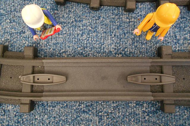

Artist impression of the front of the adaptor rails. On it I indicated which connections are important for Playmobil rails.
And an artist's impression of the rails I'd like to have..
In the end he started to work, and a colleague of his also worked on the design.
Below you will find an overview of the activities.

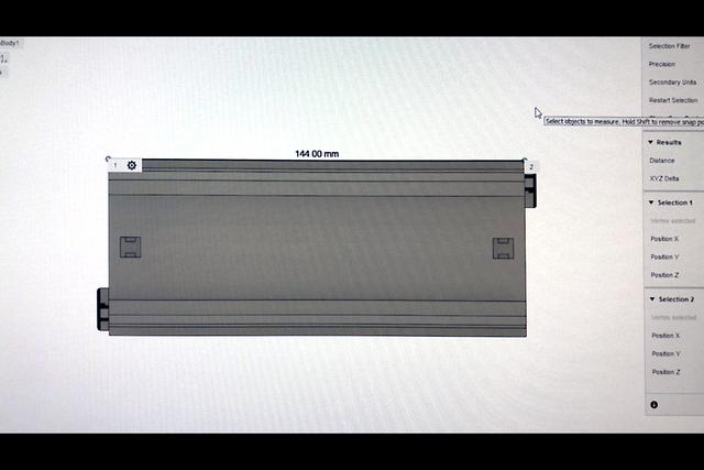

This is what the rails look like, drawn with a professional 3D program.

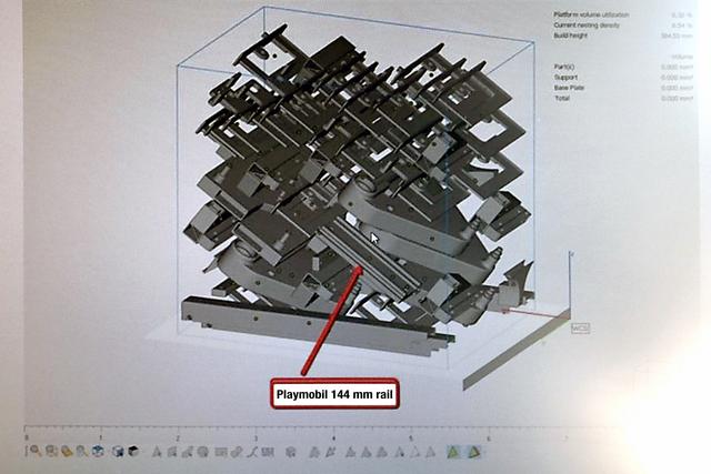

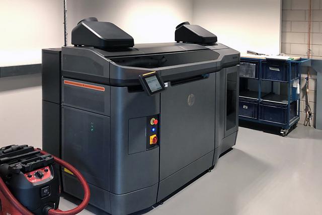

In order to make the most of a large professional 3D printer, as many components as possible must be combined. HP also supplies a program that allows you to fill in the space to be printed as efficient as possible. Between the parts that this company makes for machines is also my piece of rails.
The production.

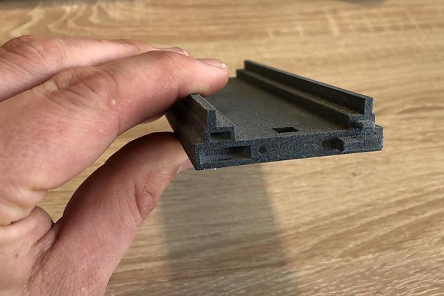

Yeah, well, then there's the moment when the rails are printed. During Edwin's visit to the Ferrovie dello Balconia, the first copy was handed over. Because it was still uncertain whether the rails would fit on the existing Playmobil rails, because we had blindly copied the design from the internet. My first impression of the printed track is that it meets high quality expectations, but the cost of 36,— Euro each is there. On the Havatec BV printer, parts are made for machines that are used on a daily basis, and then durability and high quality are extremely important. If the rails are distributed more efficient in the HP Jet Fusion 3D 4210 printer, the costs can be reduced even further, but perhaps it would also be better to wait until this technique is applied more generally and comes out of its infancy. Then there's the exciting moment: the rails fit!  For the time being I asked if one more specimen can be made, because then at least a semicircle can be made. In the meantime, my enthousiasm have been noticed at Havatec BV and I have received an open invitation to come and have a look. I will certainly do that!
The HP Jet Fusion 3D 4210. Let's say it's a lot better than a printer you buy at home. But what a beautiful machine this is. That certainly promises something for the future.

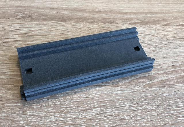

The first copy from the 3D printer.
Inspection by Henk and Ben. The rails fit perfectly, and has the approval of both gentlemen.

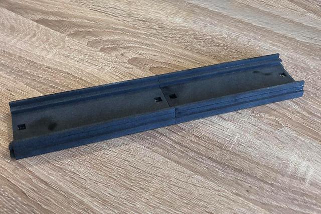

The first rails of the next batch are now being made. For the first time we were able to check if the homemade pieces of rails fit on each other. No problem. Now we have to prove that you can really make a 1/4 and 1/2 bend parallel track.
