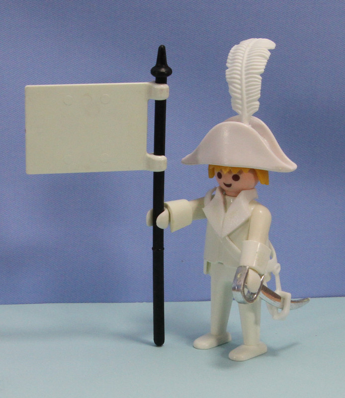

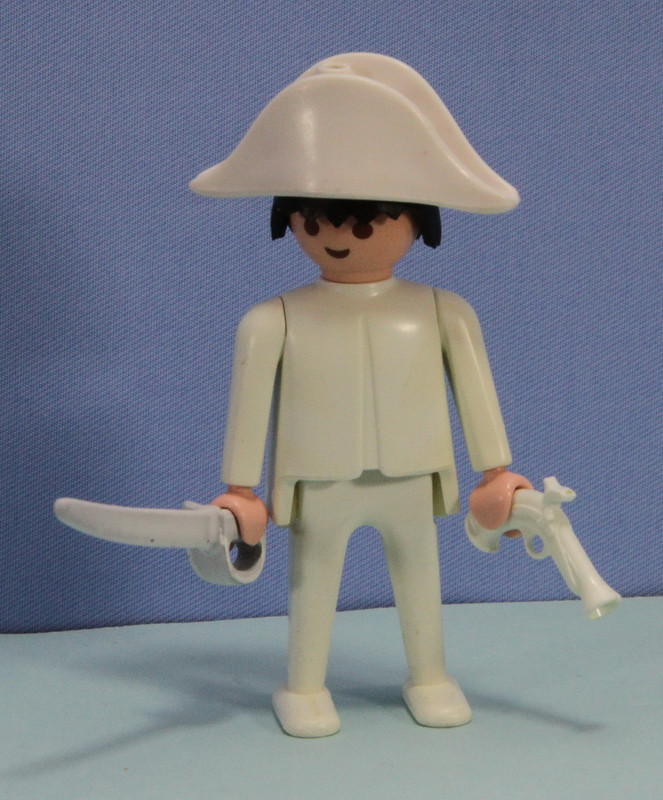

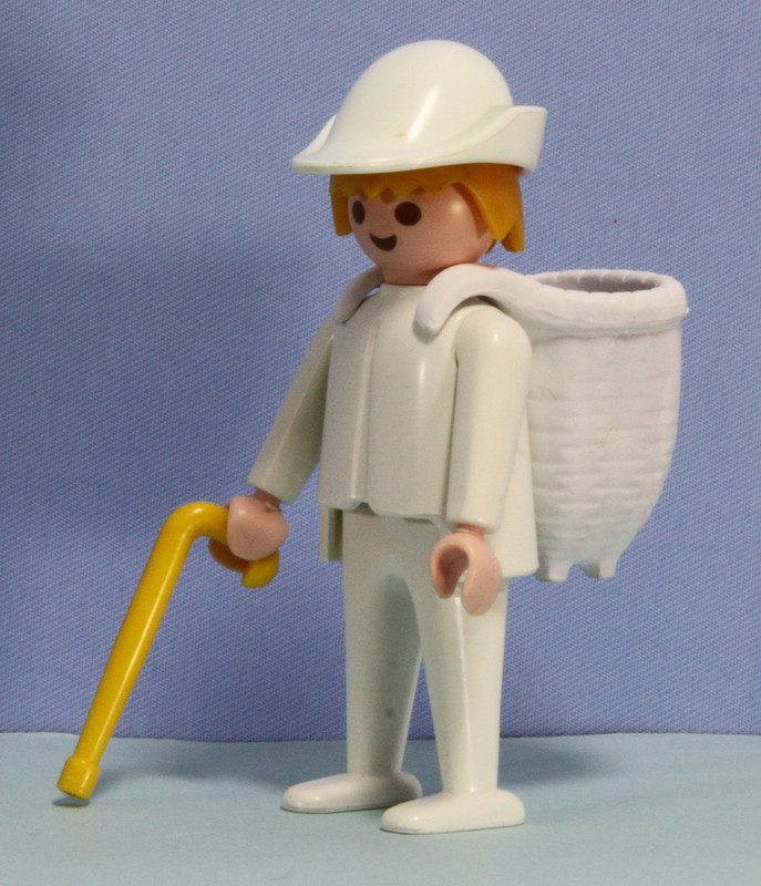

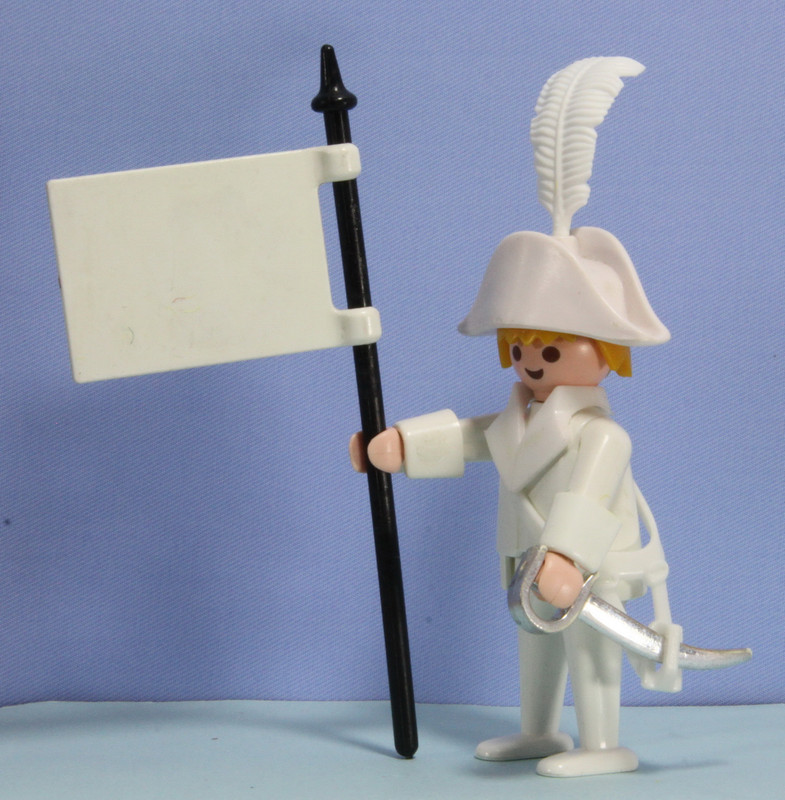

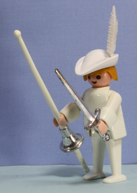

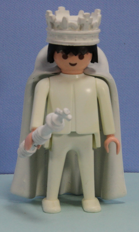

Watching what is offered on eBay revealed the existence of 15 small sets which fit in the Color theme. They were probably promotional items (‘give-aways’) but now command high prices (50 to 70 Euro each). All 15 sets have a single figure with a few accessories. All have free wrists, suggesting they were issued after 1982.
•   5 sets were issued in the UK (judging by the address on the card enclosed with each set): a pirate, a knight, a king, a cowboy and a clown, all with white accessories
•   6 sets were issued as a single klicky with mainly white parts and a few non-white parts; a farmer, a camerawoman, a knight, a guard, a pirate captain and an Indian.
•   4 sets were issued as a single klicky with a mixture of white and non-white parts and accessories; a viking, two different pirates and a lady with a hoop skirt,
Two further sets were free gifts (‘Gimmicks’) with German YPS magazines, a naval captain with fixed wrists and a cannon. The cannon was supplied with the wheels and axle separate.
13 white and 12 non-white accessories and 3 klickies in these sets are not found in the ‘main’ color sets. I made the 12 parts shown on the bottom row in the picture below by painting ‘standard’ parts white.
